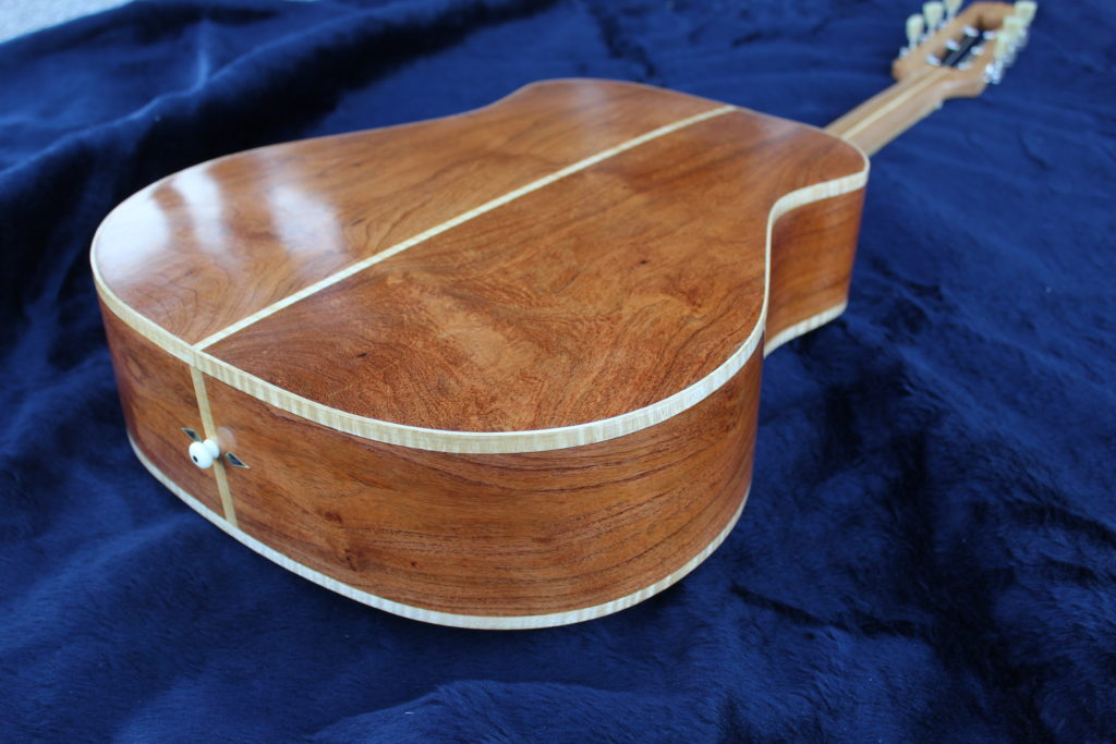

Let's see if I can post photos...
Although I am a sponsor now, I'm not quite comfortable posting in the custom shop.
Carpathian spruce top with mesquite back and sides
My Open Headstock...

I can see the photo's. It's an interesting headstock design, those are normal tuners on edge then?

Yes, they are regular solid headstock tuners. I believe I borrowed the open headstock idea from Mario Proulx, but it may have been Steve Sheriff. At any rate, I got the idea from a guitar I saw online, and developed my own design from that.

Cool guitar. I like the wood grain on the back and sides. Head stock is pretty cool. I’m shocked that the open design works with that much pull on it.
Gotta ask... what was the reasoning that the upper shoulders (not sure what that is actually called) is more blocky than normal? Had does that effect the sound?

The shape I copied from a 1936 Kalamazoo that came through my shop back when I did repairs. I liked the way it sounded, and also the smaller body size, so I traced the shape and measured the depth at the neck and heel. I didn't do any reasoning about the shape, just did my best to copy my tracing.

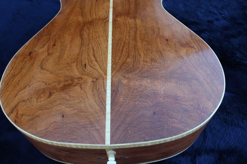

Beautiful guitar. I hope it sounds as good as it looks, because that is a gorgeous one. I love the Back and Side wood, what is that?

That back and side wood is mesquite, which I really like. This is the second guitar I've made from mesquite. It's really dense, and is more toward rosewood than mahogany. My first is here:

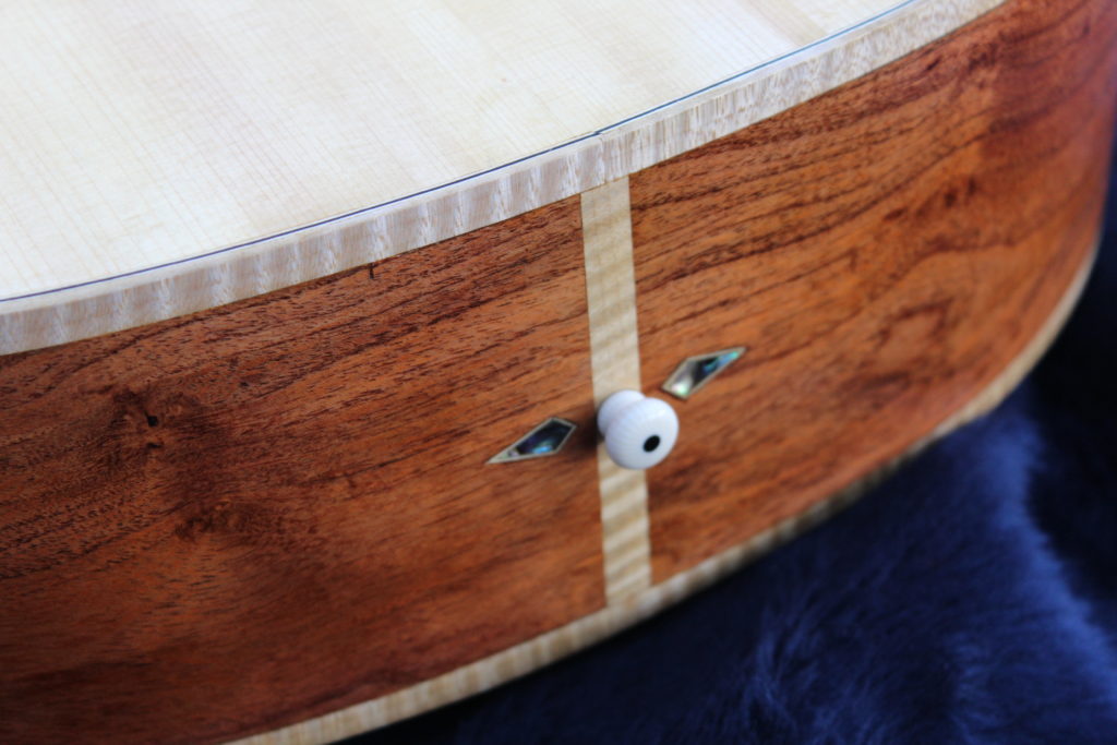

I am going to take a bold step and offer some feedback. I love seeing new guitars on the forum. There are some things I like and some I dont about this one starting with what seem to me to be a large pickguard. The finish and fit looks great and I admire anyone that can build a guitar. I would like to have seen some development pics.

Last year after some 25 years of building guitars I decided to try out Tru-Oil and quite frankly I like it a lot. I had always avoided it because some how it got into my head that it's an 'amateur' finish. It's true it seems that a lot of beginners do go for it. But really what it comes down to is that it's a varnish. It goes on very nicely and I think it looks great. I'll most likely be using it again in the future.
The upper bout design is interesting on that guitar and I didn't notice it at first. It almost looks like it's thought to be like a hook for the leg rest position or something.
Fit and finish has been the biggest problem I've had since I started building guitar. IT drives me crazy quite frankly. Honestly if I could I would farm out my finish to someone who really knows what they are doing. I have NEVER finished a guitar to my satisfaction or even to that of factory standards. Of course I won't sacrifice looks over a thick tone dead finish either, these are musical instruments after all.
Fit I have gotten a lot better at and what helps there is the proper tools and sharp ones at that. If I was going to ever run a luthiers school, which I never will, The very first lesson would be how to sharpen a chisel and a plane and no student would be able to proceed if they cannot shave the hair off their forearm with it

I agree that the pickguard is oversized. I built this one for a family member that is just learning, and the TruOil finish on the top is very thin and not quite as hard as nitro, so I opted for more protection. I don't really like pickguards.

I started with TruOil because I had used it for gunstocks, and knew how to use it. I switched over to the old Rockhard tabletop varnish, but then they changed the formulation, so I only did two guitars with it. I've been meaning to try another of the brushing varnishes (Epiphanes, Ace, or Pratt & Lambert), but there's usually a learning curve with getting the most out of any finish and I like the results with TruOil.
