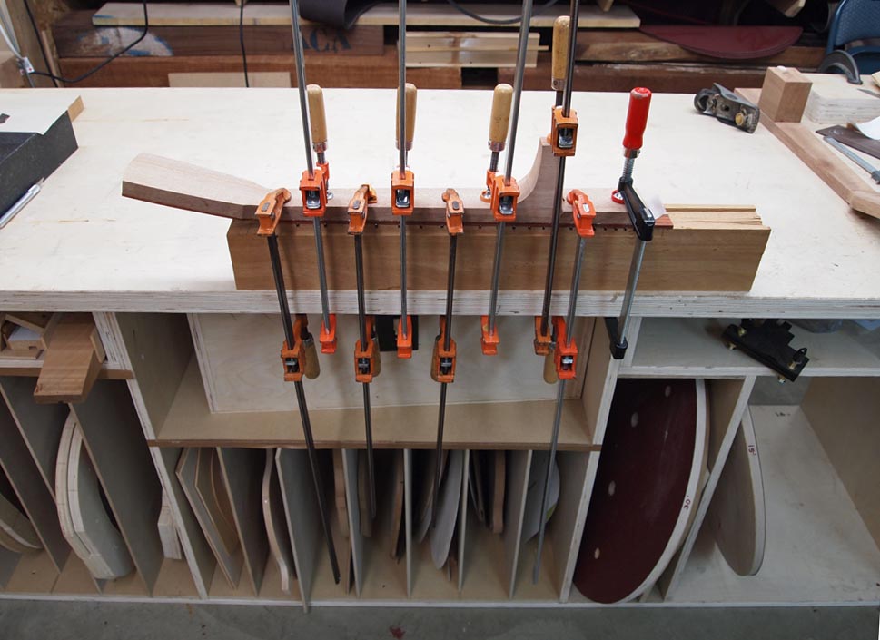

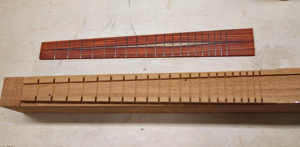

Here are two more photos of the neck going together. I like to put in the frets before the fretboard gets glued to the neck. To help that process along, I made a block that mates with the compound radius fretboard and keeps everything flat while it's being glued.
I hope to get this out to the finisher in the next few days and will take a few more pictures then.
