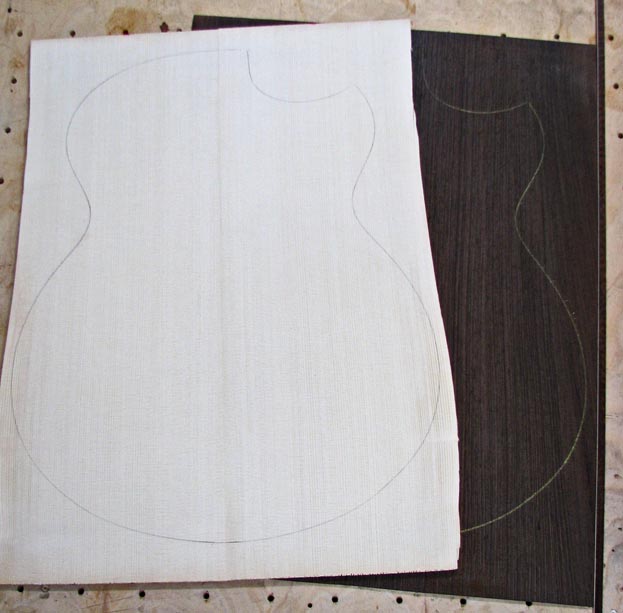

I have a client who was hoping to come by and check out the construction of his guitar in progress but the timing didn't work out. I thought this would be a good substitute.
He wanted something as easy as possible to fret with shorter stretches so we settled on a 24" scale length and are making it 13 frets to the body to keep the bridge in about the same spot as a 25.4" scale with a 14 fret neck.
Specs:
-Auditorium Body
-German Spruce/Wenge
-Florentine cutaway
-Cocobolo bridge, fretboard and headplate
-Snakewood binding
-24" scale length
-K&K Pure Mini pickup
These are "it's 10:00 pm and I want to be done for the day" photos. I'll get some better ones up as we go along.

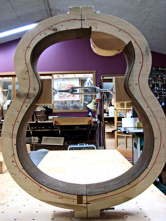

apart from being impressed how clean your shop is, I really like Wenge when it is quartersawn. It is just amazing how straight the grain is, wonderful. I have a bunch of Wenge furniture at home and it is actually annoying how it looses color when exposed to the sun, but I guess that is not an issue if you keep it in the case.

Good looking, Kent!
But what I really like is your purple wall!
How regal.

Dang Steve, I could't take my eyes of of that purple wall either As usual Kent everything you work with turns out beautiful!!

Wenge will lighten a bit over time with UV exposure but not as much as Walnut from what I've seen. And I've never seen that happen on a guitar, only on stuff that gets left in direct sunlight for years.
Greg and Steve, I beg your pardon, that is not purple! That is the designer color "Evening Plum Sunset" and I picked it out special. Out of a free pile.
It does liven up the place.

Greg and Steve, I beg your pardon, that is not purple! That is the designer color "Evening Plum Sunset" ...
Yes...yes...I can see that now...
