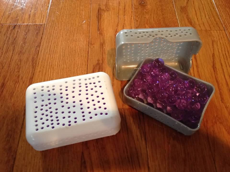

Waterbeads in drilled out soapdish.
You can get both from any craft store or dollar store or Amazon.
They keep my guitar cases at about 50% and only need to be recharged about every 6 weeks.

@lowrider - How do you maintain a proper humidity level with the water beads? I see some made for humidors, usually 70%, some 60%.... been trying to find some 50% ones with no luck. Are the regular cheap water beads just luckily around 50%?
@GoPappy - I have those now, and I agree... most of my guitars are fairly cheap, but my acoustic, although not a sought after model, retails fairly high, though I got it barely used for a steal. Still, very nice and not wanting it to crack/split. That said, the Boveda... I think you need 2 sets of pouches. 1 set in the case and 1 set recharging. My issue now is mine are recharging but not very well, lots of hard chunks, and take 4+ days to recharge. Those water beads and sponges, take minutes.
@zovanou - Those sponges, PVA... I'll have to look into. I know the Mr Clean ones are dense but also made of an abrasive material. Those PVA look about the same, minus the abrasive.
As I mentioned, I am learning 3D software/design and printing... rather learn making something useful which is why designing something for the guitar vs buying it or using a ziplock.
Are those water beads prone to dripping?
Was thinking making a double wall design so if drips, it drips inside the humidifier itself instead. Not 100% sure how to make it such it sits inside the hole at a 90% angle for upright storage without twisting the strings too much. But, if I use the beads, I don't need to worry about cutting up sponges to fit.
