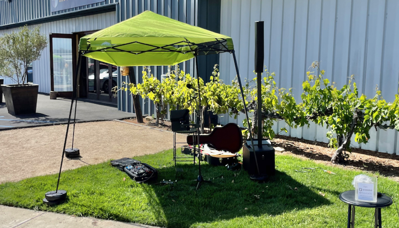

First up, we decided to do an outside test of the EV30M compared with the EAE D6-58. These systems have some similarities but mostly are very different. The EV30M is much more powerful (1000 watts) vs the D6-58 (120 watts) and of course the EV30M is a stick system with a subwoofer base unit and 6 tweeters on the column while the D6-58 has four speakers packed into the cabinet including an 8" woofer, a 5.25" mid and two 1" tweeters. Both have powerful, built-in mixers with multiple inputs (8 for the EV30M, 6 for the D6-58). The EV30M needs to be plugged into an AC source while the D6-58 can run on AC or its internal rechargeable lithium battery.
Setup (and breakdown) of both systems is quick, easy and straightforward. For this test I put the D6-58 on a pole which is mostly how we used it anyway. So carrying and setup is about the same for both. I would say that neither of the mixers is easier or harder than the other as both require a little getting to know them to get the most out of them. The EV30M mixer gets an edge because it can be run completely from their decent app on a phone, computer or tablet. This makes tweaking sound from out front easy and ensures the best sound.
As far as the sound comparisons, while the D6-58 is no slouch, it just can't hold a candle to the EV30M for power, clarity, dispersion and throw. As you'll see (hear) in the following videos, the EV30M with its dedicated subwoofer on the bottom and 6 tweeters with vertical (actual) and horizontal (guide shaped) dispersion plus all that extra power makes for just way more and better overall tone. But again, we are comparing apples and oranges to a large degree here.
Anyway, we are very happy with the EV30M and we're ready to use it live very soon. We're on a two-week hiatus including a week-long beach vacation so we won't be testing it at live gigs for a few weeks but I don't expect any issues. I'm very comfortable already with the operation and having the mixer controls literally at my fingertips in front of me on the tablet means I can quickly dial in or out any issues that might pop up. I'll be sure to post a final update after a few gigs to report any challenges.
For the videos, the usual caveats apply: Listen on good speakers or headphones for best results. They were recorded on a Samsung Mobile phone so some auto-leveling is in play. Last, I live near a small airport so plane noise is usually present here and there. Also, sorry for the fingers drifting in front of the lens here and there but it's hard to walk about my yard with all of my wife's little rock gardens without face-planting. Not too high tech here, but would a Methos1979 video demo be any other way? No, of course not!
Video 1: Live playing comparison of EV30M and D6-58, directly in front, approximately 20 meters out.
Video 2: Streaming YouTube audio comparison 20 meters in front then sweeping 180 degrees side-to-side, comparisons at 10 to 30 meters.

Originally Posted by lkingston View Post
On the other positive side, that tapering off of high frequencies is easier on the ears when you are playing loud enough to have to put the column beside rather than behind you. I really don’t see the 120 degree dispersion as a negative.
Agree here as well. I was thinking that one of the 'plusses' of the Bose's 180 degree dispersion would now be a negative for me when playing at higher volumes. While great for some venues, for the vast majority it would be overkill and at high volumes would be a negative both for performer and feedback issues.
You probably would want more at one of those outdoor stages where people put up folding chairs and where there are food trucks.
I'd just use the D6-58 and/or one or both of the S1's in this instance.
But yeah, it will handle almost any of the actual small establishment gigs that we all do.
Same with us. One thing I liked about it was that unlike the D6-58, the EV30M's volume and tone seem more linear. In other words, whereas the D6-58 (like the S1) seems to have a minimum sweet spot below which the amp does not perform well for really quiet venues (like some of the smaller assisted living facilities we play) the EV30M can be dialed way down and yet still give you a nice clean and clear tone. So whereas I thought the EV30M would only be used for the larger rooms, I think once I have it dialed in well that we will use it for just about everything we do.
I’m looking forward to your more in depth report!
We've got a gig today that we'll use the D6-58 again at but probably this weekend I'll be really delving into the EV30M and maybe recording my demo which I'll post at the top.
