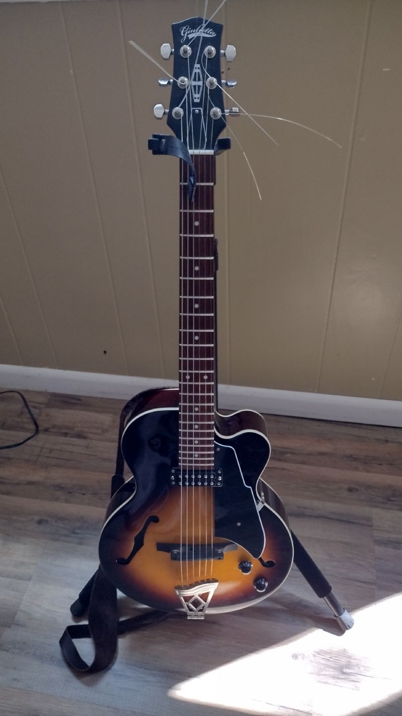

I play acoustic and electric guitar and 5 string banjo. We play everything from Wagon Wheel to Whipping post. I saw the VOX Guiletta 3D in a used store with all kinds of modeling that sounded decent on Youtube bur really couldn't stand 90% of the tones it produced. However, It's a really comfortable small body, short length guitar for an older short guy with a bum left hand.
So pulled out 1/2 lb of electronics, not including batteries, and it became pretty resonant so figured try to make a hybrid to avoid swapping electric and acoustic all the time.
Swapped out the Tune-o-matic archtop pickup with a used Fishman archtop pickup wired to Schatten thumbwheels in the pickguard and put a split coil in the humbucker that sounds pretty good.
TRS out to a Baggs acoustic preamp for the acoustic and pedalboard for the electric.
Likely adding a blend pot at the previous 3 way switch and maybe an on-board preamp and square tailpiece.
Only thing to work through is the Fishman bridge is way bright which I wasn't expecting. I think the piezo is loose from the saddle.
Sorry about the strings, she's still on the bench.
