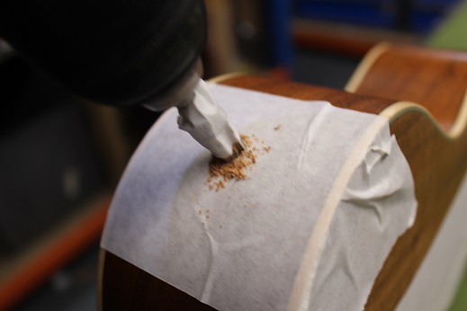

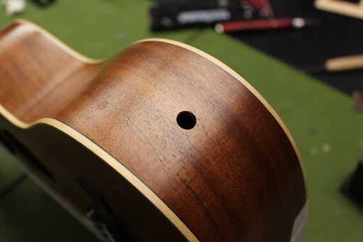

I use a step drill when i do it, heres a hole being drilled into the side of a uke with a stepped reamer, so very fragile and splits real easy
Endpin situation
If the step reamer is not quite the perfect size,i follow up with a machine reamer, i use these as i have every size from 1-15mm in .1mm increments
