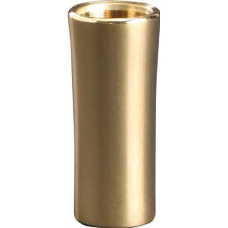

If I was playing squareneck, I'd want no variation of string height, like on my lap and pedal steel guitars. But playing "Spanish" style makes the slide behave a little differently, coming at the strings from a less-than-level orientation. And I think the contact angle probably varies depending on which finger you wear your slide on.
Lastly, they make contoured slides, like the Dunlop Eric Sardinas model, which is highly convex shaped and flared at one end; this may be more desireable for electric guitars, and for resonators whose saddle radius is more pronounced.

I have used a bunch of different slides and long ago settled on radiused ones.
I too like low action and do a lot of regular fretting when also sliding.
I am sold on the Eric Sardinias Dunlop slide. The medium fits my pinky great. They weigh less than most and this helps me play with a lighter touch, for less fret bonk.
I have spent a LOT of time getting decent at lap slide on my “Spanish” style low action guitars, so I can play a few songs in that way at gigs where only one guitar gets to go.
I now use the ES slide like a lap style steel tube, and the radius is a huge help.
