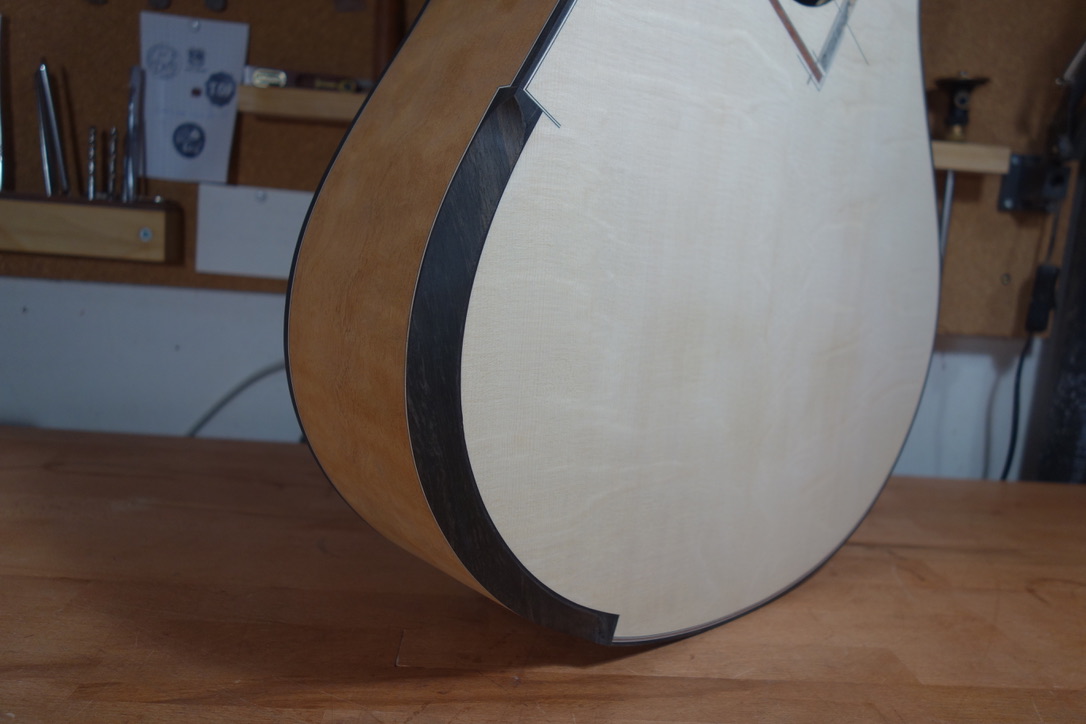

Max has come up with a body shape that is flowing, curvaceous, and inviting to hold. The addition of the beveled upper bout will make it even more comfortable to spend long stretches of time with.

Here are some good pictures of the bevel where my arm will rest. This feature really enhances the beauty of the instrument for me.
