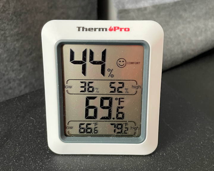

Just case it when you don't play it and invest in a decent hygrometer so you know the RH in there. Guitars aren't "so fragile" but they're wood and can be damaged by humidity not to mention other critters in the home. It's all well and good to want your guitar out to play it but I leave the case where I can see it and then I get Christmas every day when I reveal the contents and start playing.

Without knowing what the humidity is would bother me. I KNOW its gonna be too low in winter.

Yeah I’d just get yourself some humidity readings in that room. If it gets to the low 30’s or lower, an evaporative humidifier is a relatively inexpensive investment that will keep your guitar safe.

I'm in NC, but on the coast and have kept all my guitars out on stands or hangers for years with zero ill effect. I never have more than a week in the winter that humidity drops below the mid 30's. I do keep hygrometers placed around the house, but I always know when my guitars sound the best the %'s are getting close to the thirty's
