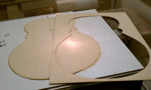

And here it is in Mike's workshop, in the Meridian template.
Hoping for more photos soon!
