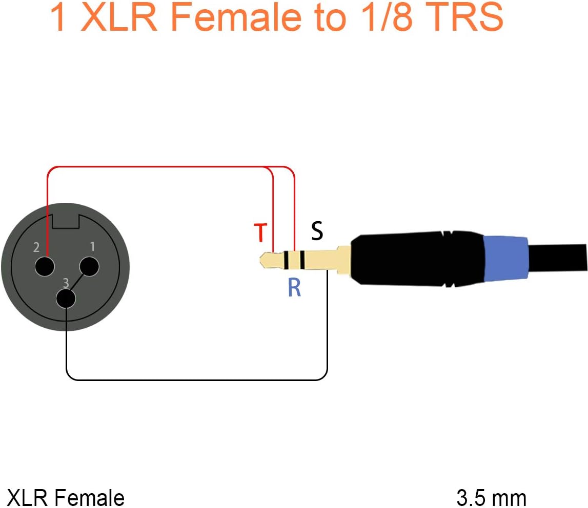

The audio signals are out of phase on the two wires that carry the audio in a balanced connection. If the signal in these two wires are summed (added) in a mono connection like what a TRS plug may do in the phone, the sum of the signal will be zero if they are perfectly equal. The phone connection may create a connection that sums out the audio and allows any noise on the cable to be amplified.
The other issue may be a level mis-match, as the preamp will be 'line level' and I assume the phone to some kind of mic level.
I have used a cable linked below to connect camcorder mic inputs. I don't know if it would work with a phone or not. The pin 3 of the XLR gets connected to the sleeve/ground of the TRS and creates an 'unbalanced' connection to the device it connects to. Not the best way to do it, but may work. There is a diagram in the link that shows how the XLR and TRS plug wiring is done
https://hosatech.com/products/analog...bles/xvm-100f/
https://www.amazon.com/Hosa-XVM-102F...ef_=ast_sto_dp
There maybe a better way to connect the mic preamp to the phone using an interface of some type. Others on this board could better direct you on what might be needed to do this properly, as I primarily use a computer with a USB interface.
Crude diagram of a balanced XLR to TRS and the phasing of a sine wave signal on each conductor
(Missed marking the 'T' in the diagram for the TRS plug)

Clearly, I assumed too much...
As MarkF explains, the output (which is labeled on the back of the ART) is a *balanced* signal. Never mind it's line level, which might be a bit hot and impedance mismatched for a phone's headset mic (mono) input.
So, you need to get the balanced output down to mono, unbalanced, and actually just plugging in a 1/4" (6.35mm) instrument/guitar cable will do that. (Yes, it's not perfect, but it should work.) Then, you only need to have the right kind of splitter, and I'm guessing something like this ought to be close to what you have: https://www.amazon.com/KINGTOP-Heads.../dp/B08C7FLX2Y
Start with the OUTPUT of the ART all the way down, and just set the GAIN at 12:00. See if that works as you slowly raise the OUTPUT and can get a signal that doesn't clip.
Going into an audio interface with USB to iPhone adapter plug, or an interface that is iOS compatible would have been a more common way to do this.

Interesting, in the schemas I've seen, showing the XLR head-on with the middle pin below, the upper left pin is connected to the L & R channels of the TRS plug, while the XLR middle and upper right pins are both connected to the TRS ground:
I'll check what mine does (it's a "Pro Snake" bought from Thomann).
