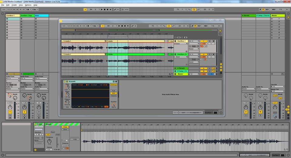

I've done pretty much what Jake above me has said. I have a 404 instead of a 202. It was an upgrade from a Scarlett Solo which has pretty decent preamp and it came with a register-able version of Ableton Live Lite 9 Daw. For what i use it for it does well and has for about a year now.
You might want check this out...
https://www.youtube.com/playlist?lis...BR6zGgZBERGktx
You can do a lot with one pre-amp.
I did this with just a guitar cable directly plugged into a Scarlett Solo. My 90's vintage Seagull Spruce Deluxe (aka Scarface) has a Fishman piezio bridge pickup. Forgive the sloppy play, I'm still trying to get this under my fingers.
https://soundcloud.com/john-krawczyk...o-clip/s-MmZsn
You can see how nice the free DAW is. Live lite gives you up to 12 channels and 2 sends. More than I need. And they give you some good compression, EQ and some modulation plug-ins. I used a little reverb and delay on this thru the sends so I get dry and wet output to the master.
I need to really learn about gain staging.
