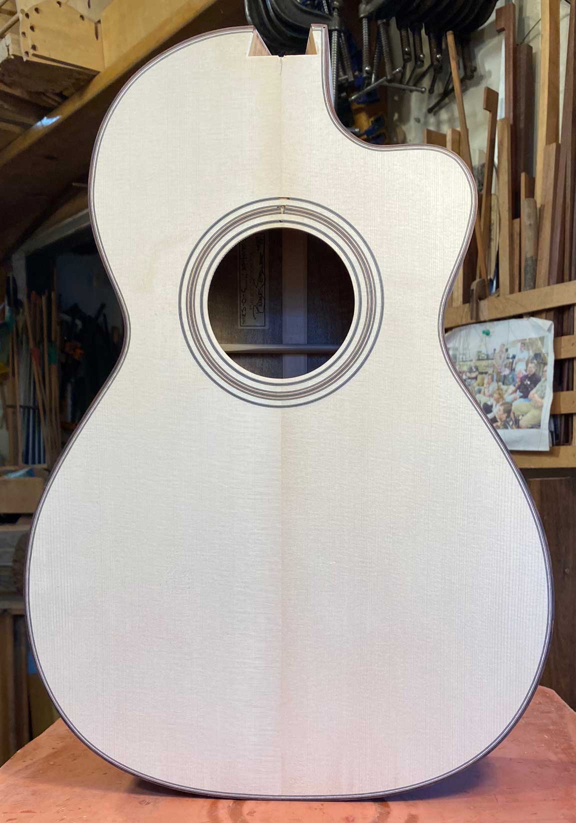

I do mind answering questions about my process. I do believe my method is better suited to the amature builder for its simplicity, and to all builders because of the ease with which one can make major design adjustments w/o spending a lot of time building new fixtures. This allows much faster growth as a builder, which is extremely important to me, and should be to most others, IMO (of course).
This Schoenberg 0 will have slightly fancier trim than a style 18 or my WRX, but is none the less intended to be less expensive than my mainstream builds. So there is only one miter on the entire box, and here it is:
Bruce

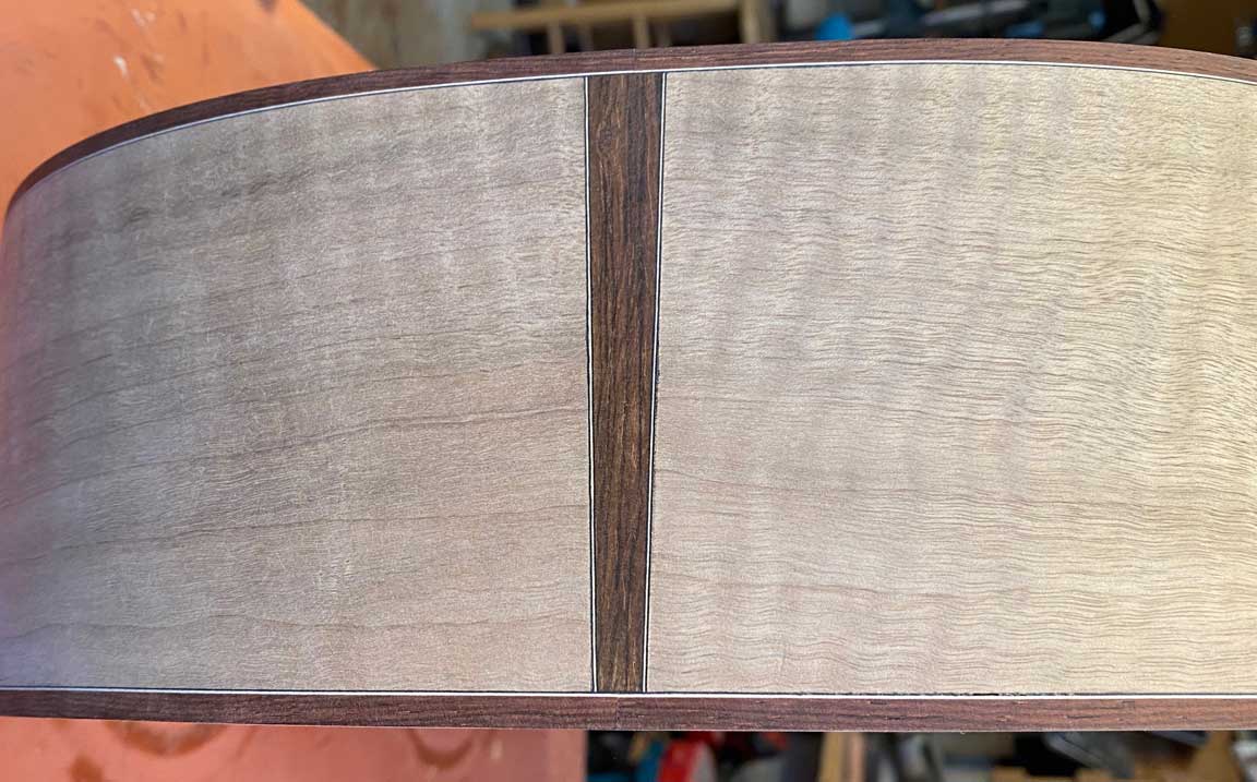

The Amazon RW binding is now complete on the Myrtle ES-0-C, and I am moving on to the neck.
Bruce

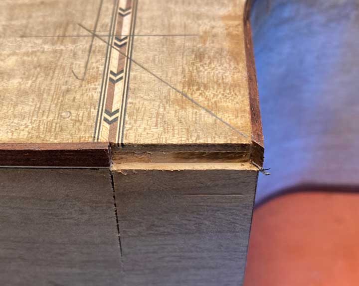

Also, I like how your pictures seem to have double meaning. On one hand, they just show the precision of your work, but, as in the picture of the neck with the cut binding, you are also showing how you trim the binding by cutting into the are that will be removed later and some insight into how you miter the cutaway part.
I am having trouble finding where I wrote that, but I assure you is is a typo, it should say "I do not mind . . .etc"
"Cutting into the are"? You're good at typos too!
I imagine that process pictures are in many ways more instructive that impressive finished product pictures. FYI: The binding miter cut was done with a fine toothed back saw and cleaned up with a sharp chisel.
