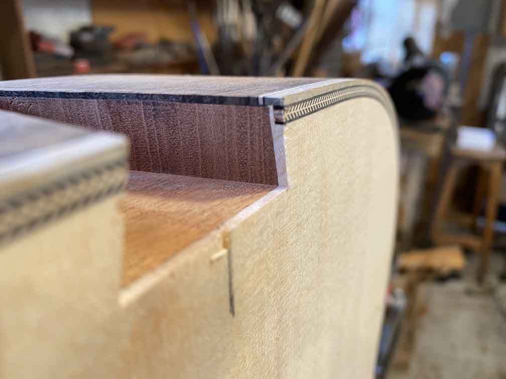

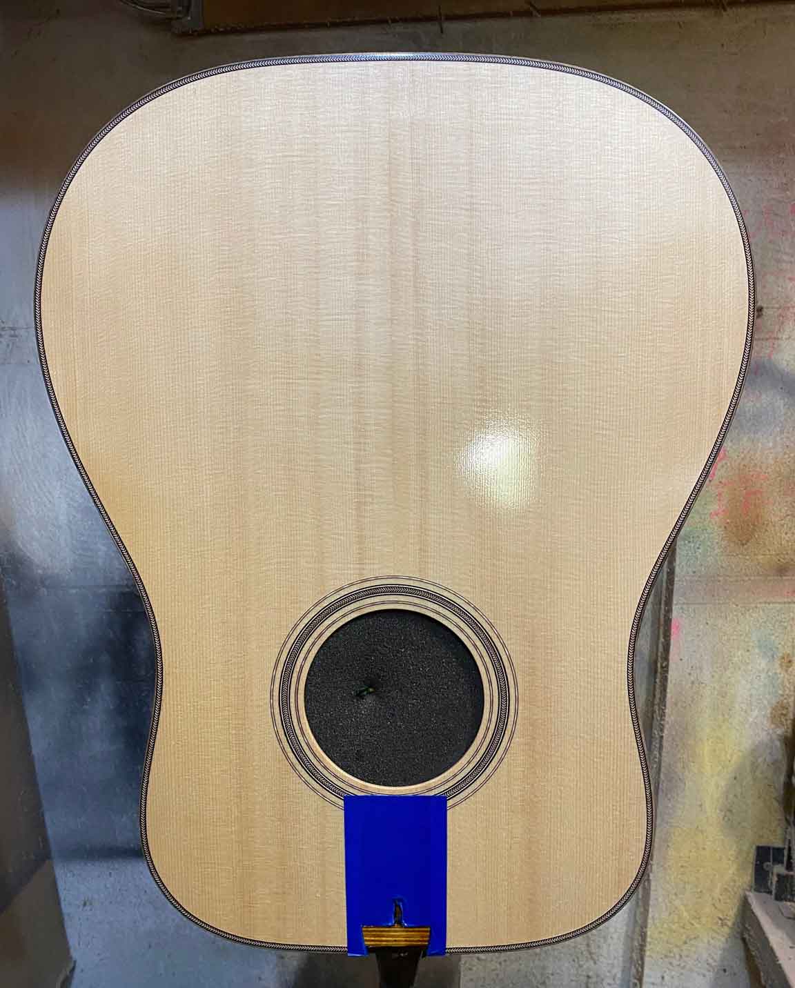

I have the top binding and purfling on the D 28-ish:

I guess your “retirement” has NOT slowed your building! Hahahaha
You might get even more done than before since you are building for YOURSELF now.
These instruments are so beautiful! Way to GO

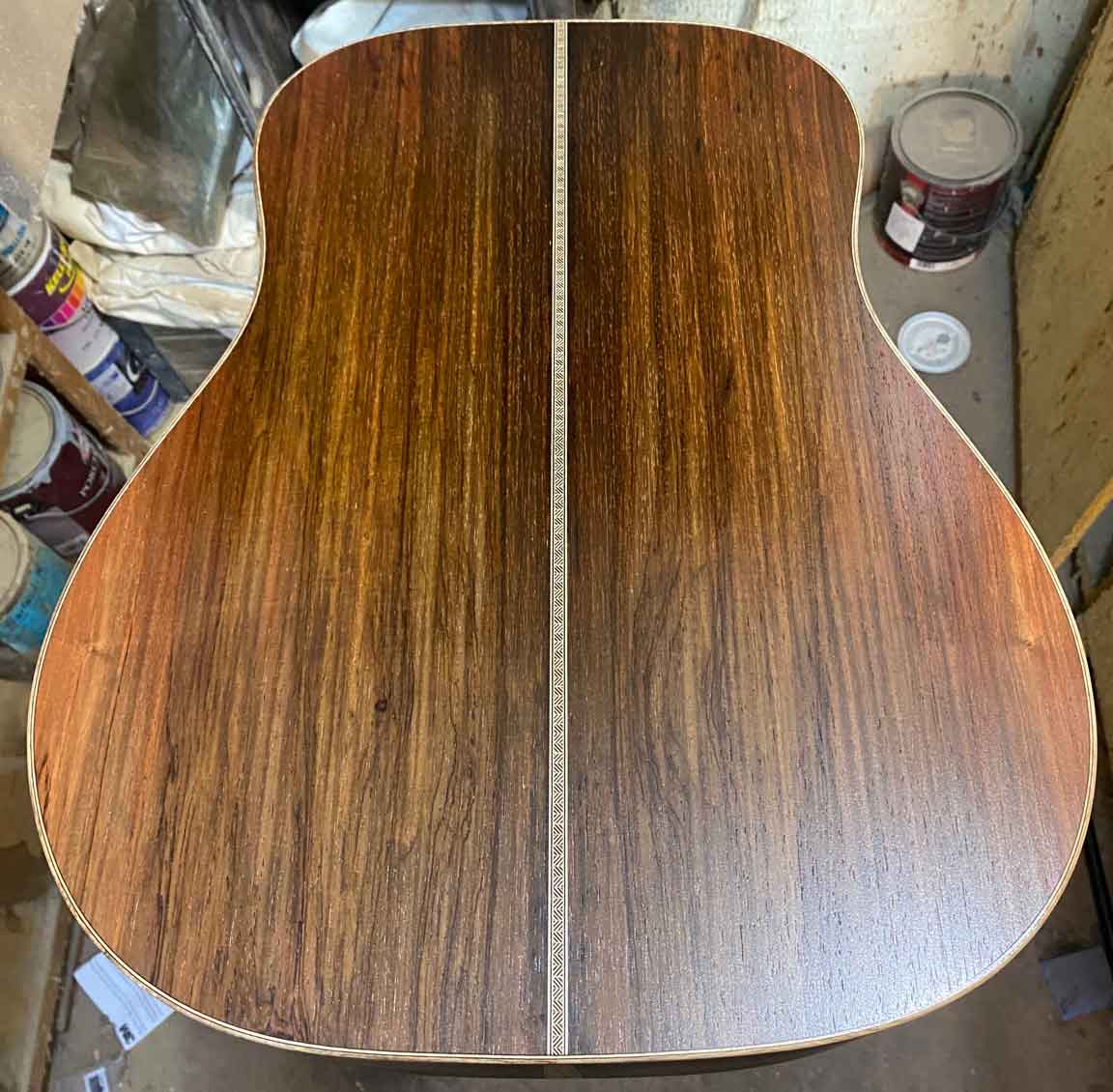

I am definitely slowing down, but not by much . . . yet.
Here is the BRW back of the current build, bound with Cocobolo sapwood, and purfled with b/maple/b. This is a really beautiful set of extremely well quartered and straight grained material with a lot of color variation.

That BRW is to die for.

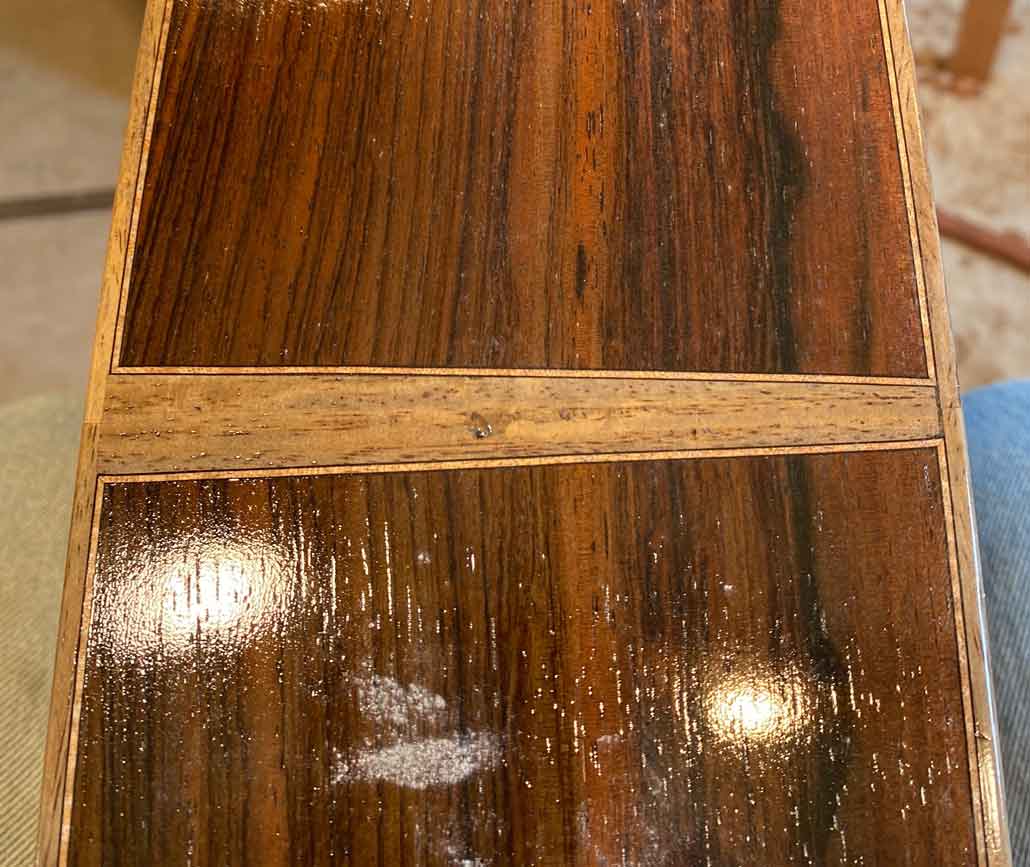

I started using Cocobolo Sapwood in place of Ivoroid plastic binding several years ago. The first such was the BRW single 0 I made for Bob Berger (2/5/1). It can be challenging to find the material as it usually gets thrown out after being trimmed off of the heartwood. I no longer seem to have a piece big enough for a heel cap, so I used a piece of Ebony sap wood I've had laying around for a few (20?) years.
