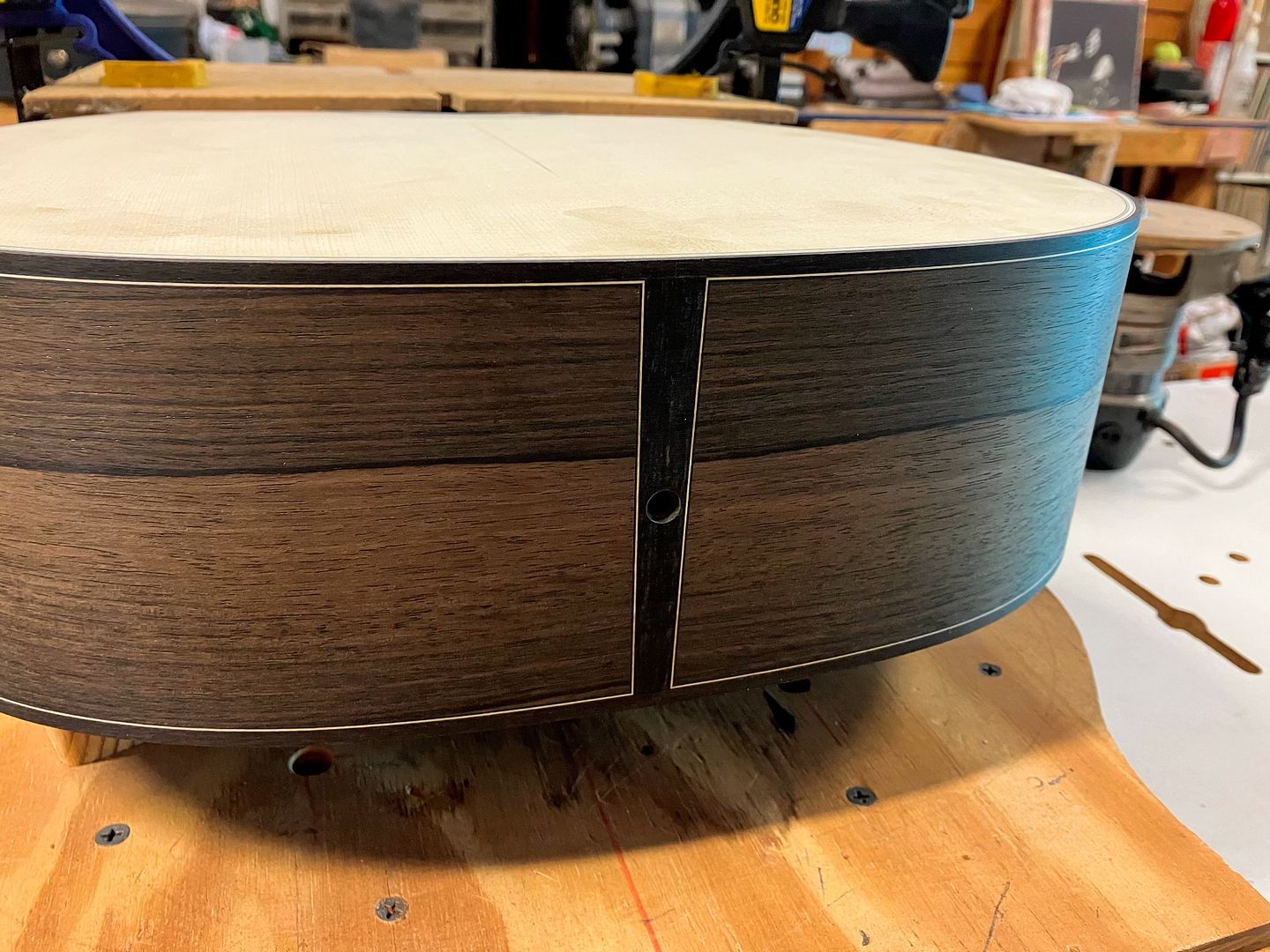

John has routed the dovetail pocket. Check out the precision on rim miter where the two sides meet…
The beautiful two tone heartwood landscaping of the Malaysian Blackwood rims can be seen set against the Gaboon Ebony end graft framed by John’s mitered flamed Maple purflings.

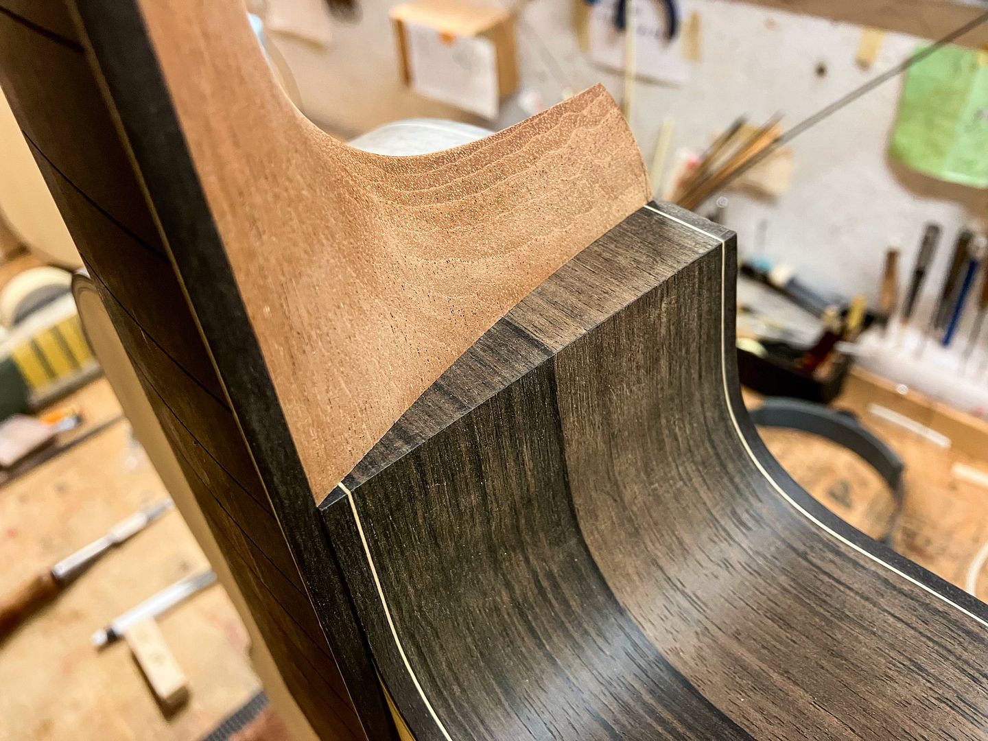

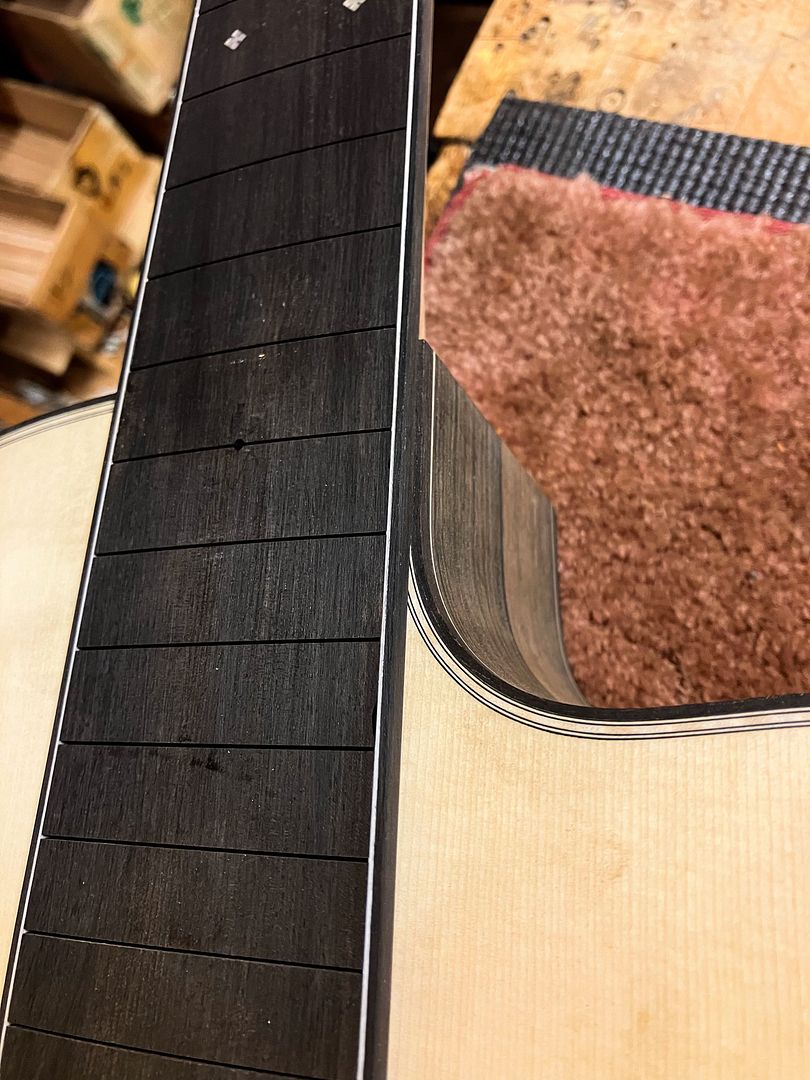

Default Neck Set
Simple Gaboon Ebony bindings with white purflings and short pattern diamond and squares position markers.
Fitting the neck to the dovetail joint. Check out how well he executed that miter joint on the rims…

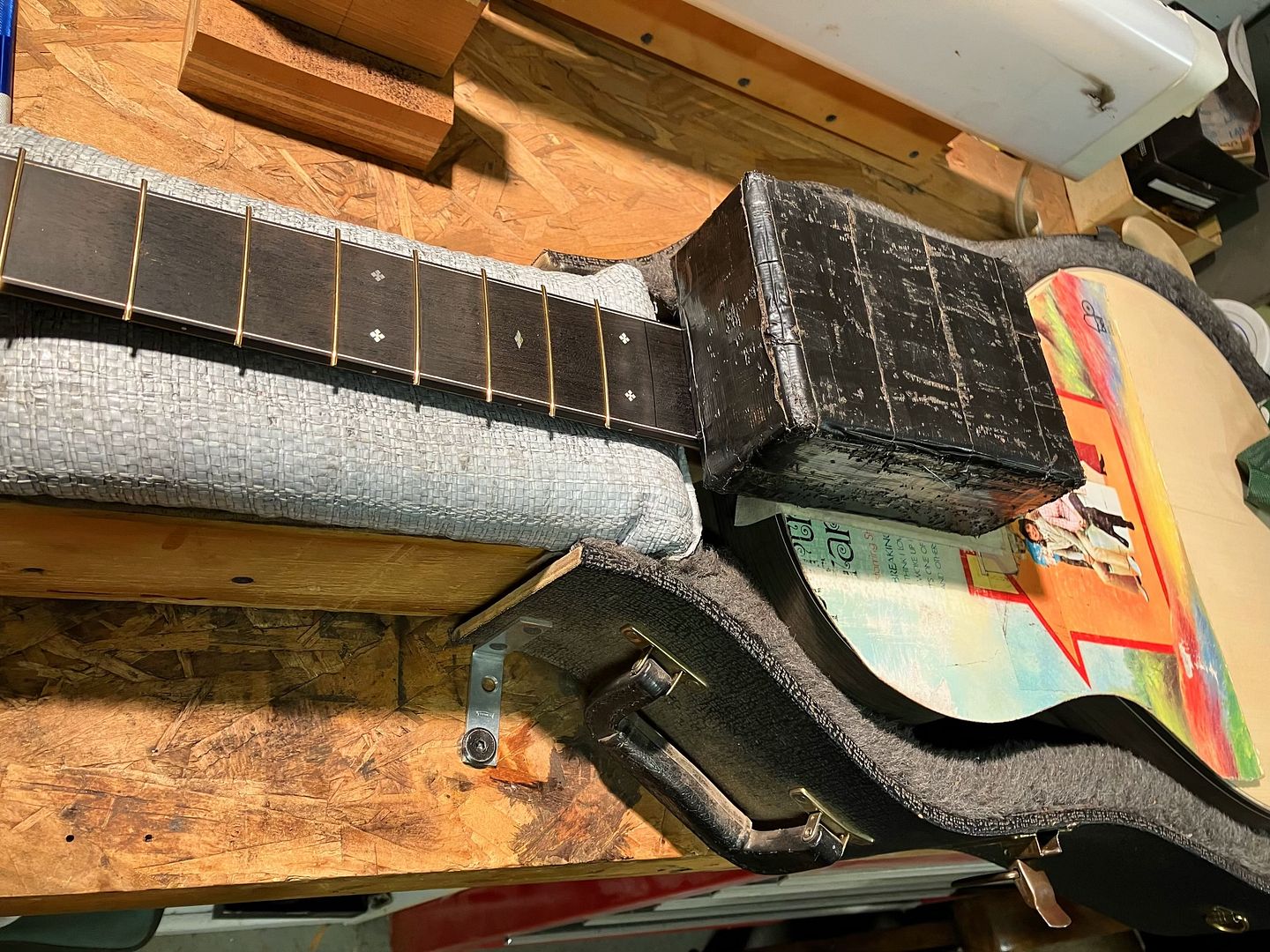

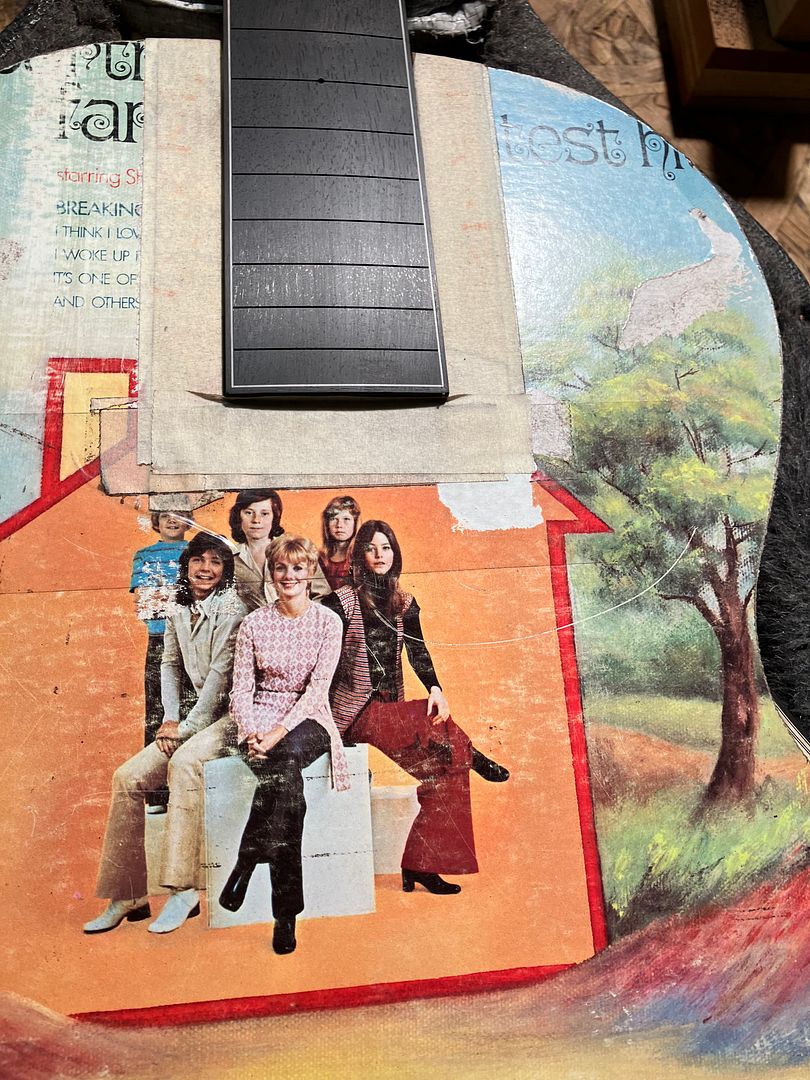

Default The things that luthiers do to amuse themselves…
Fretting with Jescar EVO 0.043” x 0.080” wire.
John’s method has a large support bag of lead shot under the neck, and a box of shot in top too!

  #111
Old 09-04-2023, 06:01 AM
Richard Mott Richard Mott is offline
Join Date: Nov 2010
Posts: 394
The Partridge Family album cover to mask the guitar top is an absolute art piece!

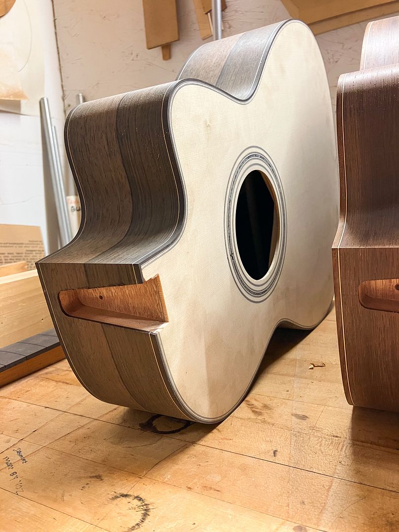

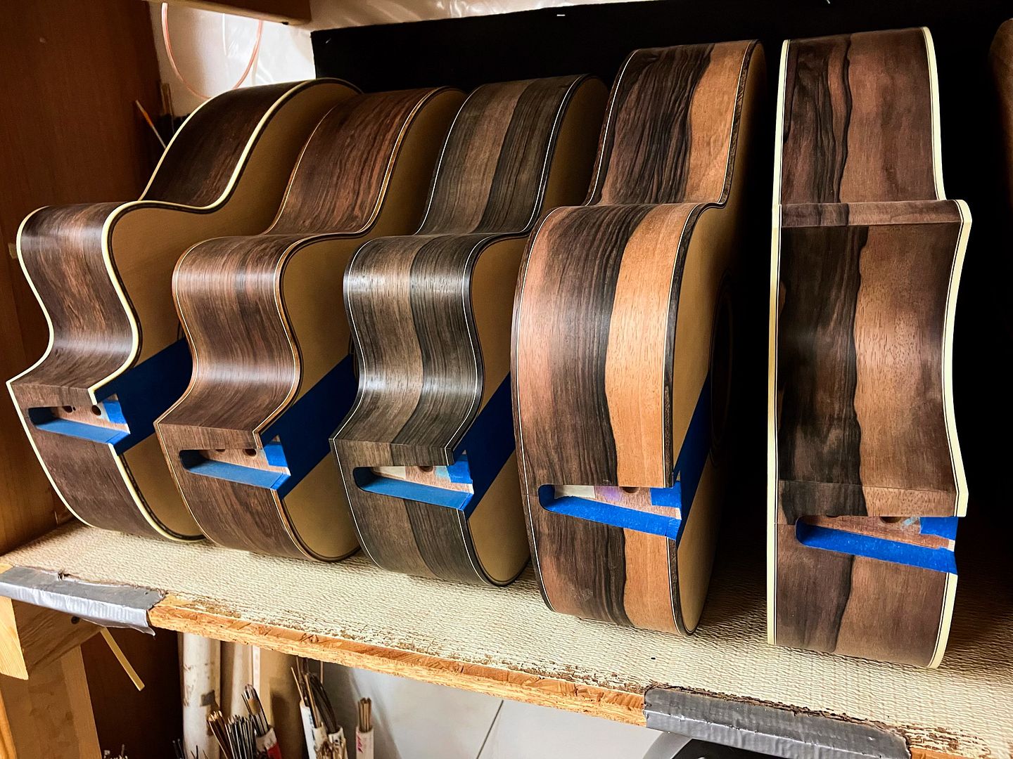

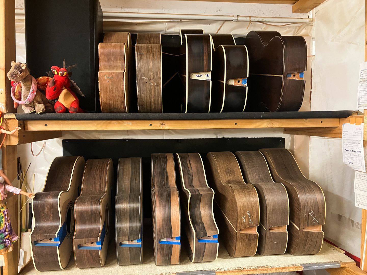

Default Pretty Rims
John has five guitars ready for finish including mine seen in the middle (left to right: Madagascar Rosewood, Brazilian Rosewood, Malaysian Blackwood and two Macassar Ebony). He is waiting for more conducive weather to spray nitro.
Here’s a wider view showing all 13 guitars being built in his shop including Juston’s Style 34 seen on the top shelf.

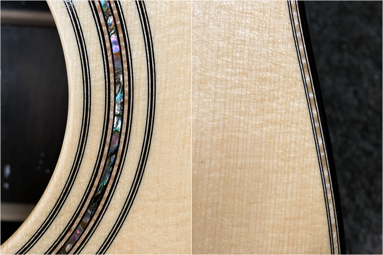

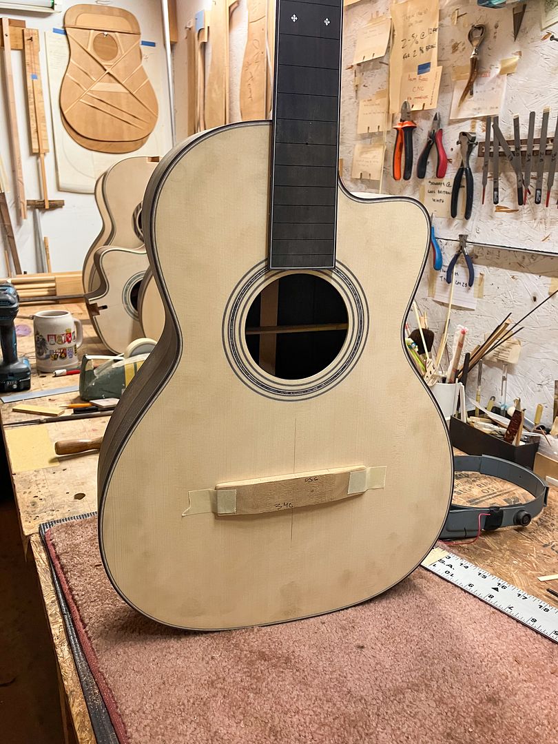

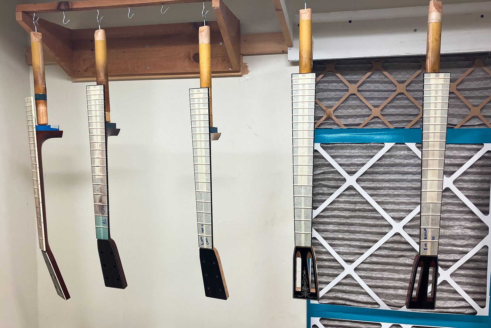

Default Out of the Spray Booth
John has finished his application of nitrocellulose lacquer and the long drying process has begun. While in shop photos are always a challenge, John was kind enough to forward a few. The curly Maple top purfling can be seen against German Spruce soundboard (left) and the landscaped heartwood and sapwood of the Malaysian Blackwood back are beginning to show.
Instead of traditional Nazarethesque (I invented a word) Ivoroid plastic, John used some curly Maple in both the rosette and top purflings.
My neck is the one all the way on the right.
